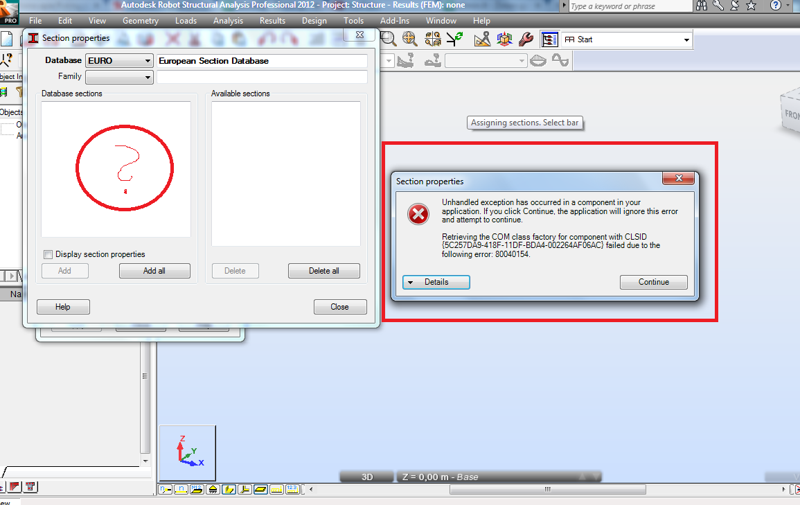

Сообщение engineer69 » 17 июн 2013, 23:06
Hi, does somebody know what is the problem? I went to geometry-properties-sections-section properties and it doesn't show me any profiles from EURO or GOST...

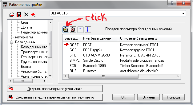

engineer69 писал(а):Hi, does somebody know what is the problem? I went to geometry-properties-sections-section properties and it doesn't show me any profiles from EURO or GOST...
Hello. Not loaded database. Check in the "Tools" -> "work settings" -> "Database" -> "Database steel and wood." If there is nothing, then click the "add a new database to the list" and select the desired base. If there's nothing there, then the database is established.
