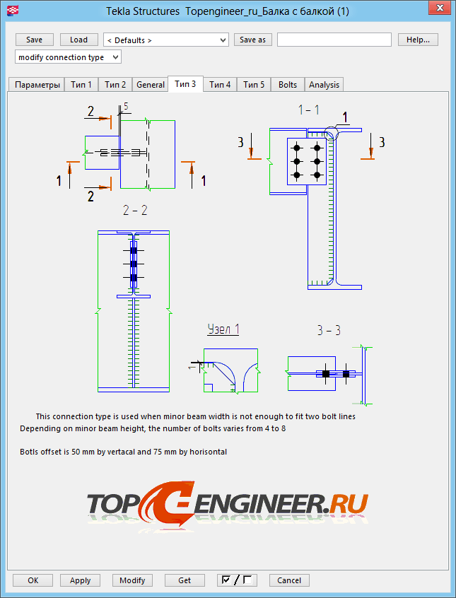

This component creates a connecting between beams with different sizes, which are located in
the same horizontal plane. It consists five types of different joints. Depending of
connecting beam’s parameters the appropriate connection will be created.
Thickness of connecting plates and number of bolts are chose automatically. You should know,
that those parameters are depending of standard series. Chamfer size calculates as a I-beam
rounding radius +2 mm.
Component can be applied in any environment. For correct plate marking into specifications,
just chose their prefix that shows sheet material in your environment.
For standard environment that prefix is “PL”, for KDM_Rus and other Russian environment: “—“
