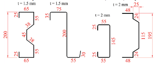

Hi guys, does anybody have some information about thin-walled cold-formed sections for built-up steel columns? The use of thin-walled cold-formed sections for built-up steel columns, calculation features?

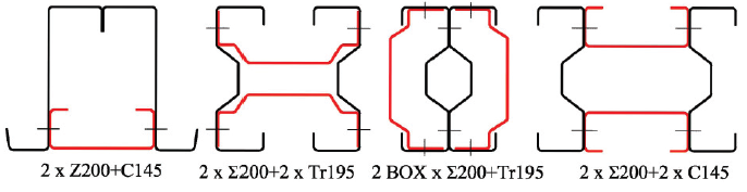

Normal cross-sections look like this:
normal cross-sections.png (37.96 КБ) 6583 просмотра
But I need methodology of built-up cross-sections, for example:
built-up cross-sections.png (65.45 КБ) 6583 просмотра
